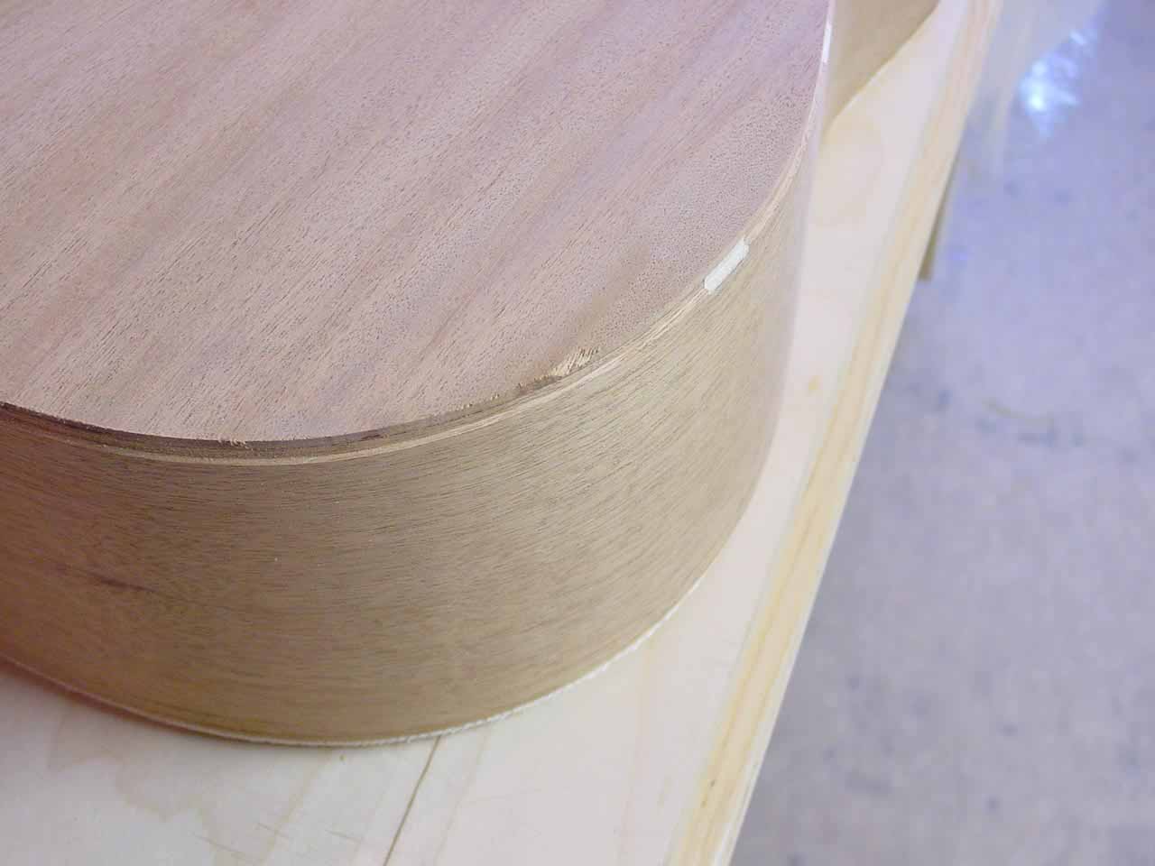

I have a binding question? It appears that I have made a slight blunder. It became very apparent after cutting the channel for the purfling and binding. For the most part the cutting worked very well.

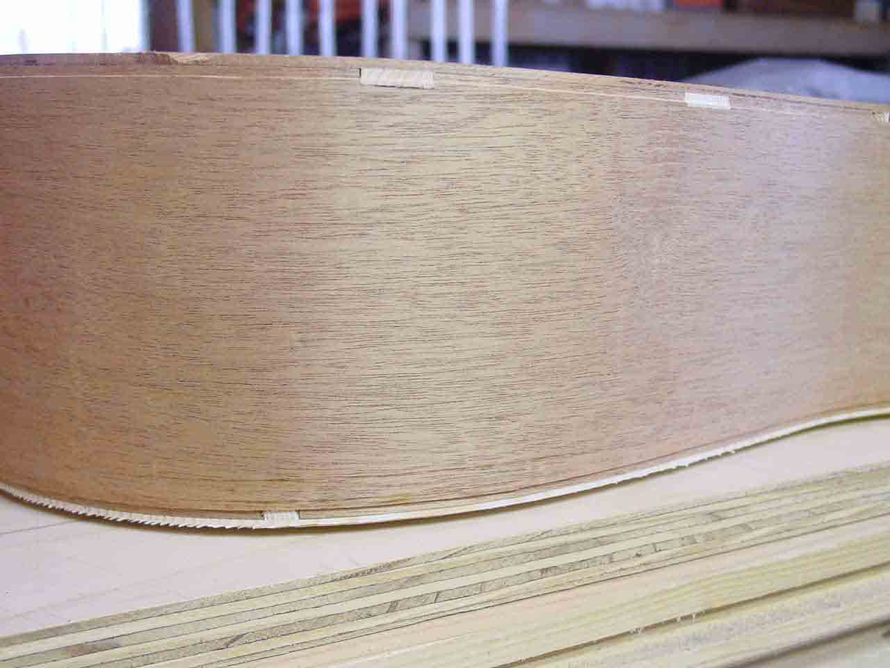

I Hate to admit it, but, I did not thin down the ends of some the braces enough to allow for the width of the binding (that is, measuring along the plane of the sides of the guitar). My first thought was to purchase a wider binding made of material other than ivoroid, which I’m sure would enhance the appearance of the guitar. Though, considering the toughness of ivoroid, it makes an excellent edge protector.
Also, while cutting for the binding on the back of the guitar, I had a little tear out. I’m thinking of adding purfling to the back now. Open to all suggestions.

So, the channel for the binding is not deep enough to cover the brace stock which shows through on the side.
How much showing are we talking about once the binding would be on? You could add side purflings if it's not to much, otherwise there may be only a couple of other options.
The most obvious fix is to use wider binding material.
Or (this is more of an "unfortunately I had to do this" type of fix). Depending on your side wood (if it's dark), you could cut out the brace wood (light color wood I assume) and make a "plug" of the off cut from the side wood. If it's EIR it should hide very well, try to match the grain pattern and coloring. But this is only my initial though, I'm hoping that some more experienced builder will chime in. (I'm sure they will have better fixes than these)
I guess there could be another fix if you don't want to do either of the first. If you don't have much depth to go, you could thin the edge of the top to come down enough to cover the "peaking" brace wood.

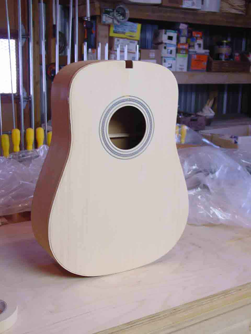

I did take some pictures and some measurements. It looks like a binding of at least 5/16" wide will do the job. A purfling of just a bit over 1/8" wide would suffice for the tear out problem on the back.
Ya know, in a way I’m glad this happened. I never liked the idea of plastic on my first guitar, and I’ve really liked the idea of purfling on the back. Also, I gonna add some inlay work using paua abalone. I figure, why not try a little of everything, even if this is my first guitar!
I guess I should mention that this guitar is a kit (Dreadnought) from “stewmac.com.” So, need less to say, a few steps in the building process were already done for me. However, I thought it best to start with a kit. That way, I could study the parts. Gaining some knowledge to what they should look like for my next guitar.
Anyway, here’s the pics.

Robert, your guitar looks great and welcome to the forum!!
I would suggest re-routing to go over the braces and then use a wider purfling below the bindings to cover that area....

looks like you need a little bit deeper binding (maybe something with a thin purfling line aleady attached) and a bit of a patch job on the tear out. with the patch i'd just make sure to keep the thing shaped the way it is now. if you try to 'neatin' it up with a triangle or rectangle it's going to stick out. a bit of monkeying around with a little chip of mahogany and i think you'll make it invisible.
the good news is that the rest of your build is looking top notch for the first guitar. looks like you're doing great work. don't let this little thing get you discouraged on #1. forge ahead.

Robert, your guitar is quite nice. I agree with Peter. Rout out the channel and add perfling. In future guitars you might consider not having the braces come all the way through the sides. I stop mine when I'm through the kerfing. I don't have the brace go through the sides. Just a consideration. Good luck!

Stewmac sells binding with purfling attached, but I think only wood. You
could glue up your own onto plastic or ivoroid.
If you go for the patch, you might get better results if you take the patch
from the scrap from that area when you trimmed the back flush to the sides.
Use it in the same orientation that it was in while it was still attached and
you could well end up with an invisible fix.

I think your right about using a scrap. I may find one lying around the router table.
Checked out Stewmac, but their binding was (.080" X .25") where as I need a min. (.060" X 5/16") I can't change the depth at .060" unless I buy a new router bit & bearing.
